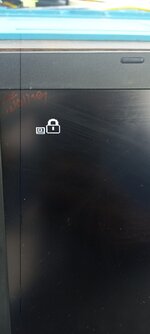

program EC ITE to remove password
yes did but password lock will open from supervisor logic.did you program EC ?
disable that option
not getting disableddisable that
This is not ec password sir this supervisor password.not getting disabled

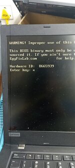

thank you so much but after pressing 1234 the laptop shutdown send another PACHET bios"Instructions for use"
Remove all battery and CMOS battery
press F1 to enter setup: password 1234
wait 20sec or more.
Enter any ID to hardware Id.
Press 2x space bar when asked.
Turn off the computer.
and restore your original bios .
Enjoy.
If 2x 5beep, it's normal.
I didn't do checksum but it must light up anyway.
Wait minimum 30sec before screen logo light on. Must turn on/off several times by itself.
this is original backupdid you saved your orginal backup ?
makethis is original backup
make the PATCHED bios and send it sirthis is original backup
?make
flash your bios now with your original backup not the patched dum

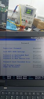

After installing this bios, press f1 to enter setup password press 1234, after 5 seconds then laptop is powering off, password is not unlocked."Instructions for use"
wait 20sec or more.
Enjoy.

send your orginal dump please
when you flash your bios an id hardware will apear send for me i will send you unlock code
